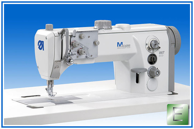

    Purchased a Durkopp Adler 867 M type Eco. It has two upper thread tensioners with the lower of the two being the main sewing tension-er. The machine has a lever that allows you to engage the upper tension er or disengage it. The manual says for sewing thick material. Can someone please explain that ? as I see no difference The manual also says the second tension er must be of a lower setting than the main.
  • Matt Sonnenburg
    I am sure someone will have more experience than I but here is my two cents. I understood the two tension knobs to aid in thicker threads. If you need a lot of tension and only have one point you have to really tighten it down like pinching the thread. This can damage the thread, so having two allows you to get more tension with less stress on the thread.
  • Krunoslav Nakic
    You are right, you have two tensions....the one you are talking about is only for the situation when you are sewing normal and there is a bulk of leather or a cross section....so in this case to sew over the short double layer of leather you can push the second tension (the looser one) to sew over the bulky section...otherwise it could happen that your thread will break due to double or triple layer of material in a cross section...I hope I could explain it to understand...
