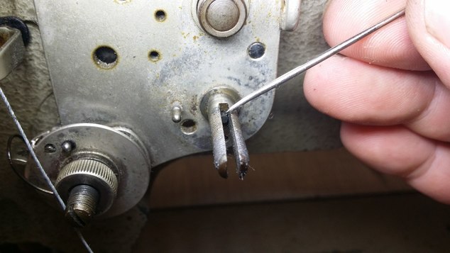

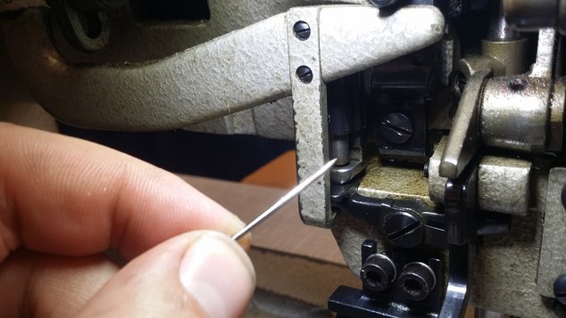

    So when lifting the presser foot with the knee lever (or foot pedal), the plates that regulate the tension of the upper thread are pressed out of each other with a metal pin (photo of the front).
    This metal pin is controlled by a metal sleeve on the back of the sewing machine. (photo of the back) ba0e3fh0kjdd5dgw.jpg

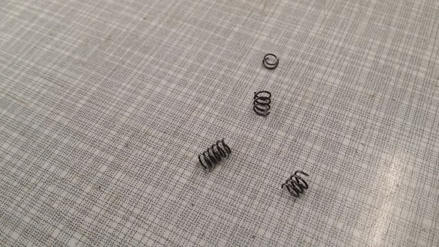

    In this metal sleeve is a small spring that presses the metal sleeve downwards when the sewing foot is lowered. This causes the metal pin of the tension of the upper thread to slip back into the starting position.
    If the spring is broken, there are fluctuations in the tension of the upper thread, because the metal sleeve positions itself more or less high depending on the gravity and oil level of the parts.
    The removal of the necessary parts is quite simple and should be no problem for anyone who can build a seat apart. I replaced the spring in an emergency by a spring of a ballpoint pen..... This works great so far! :sweat: :lol:
