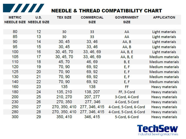

    24 size needle is gigantic for normal sewing. That size runs 210- 270 thread. Regular sewing uses size 69 , I can't remember the needle size for that thread. I'll have to check.

    I use size 21 for 69-92 thread and maybe 4mm for sewing and 5ish for top stitching

  • Mitchell Fillyaw
    I found this chart to be helpful.
