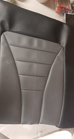

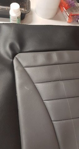

Hi all! I'm working on a seat for a 32 ford coupe. I'm trying to sew two rounded inserts into the seat. For some reason I'm struggling with this, although I've done it before without issue. It's not sewing in evenly, as you can see in the pictures.
Does anyone have any tips for this? Or can you see what I'm doing wrong?
The trick I've learned is you need to offset the outside band's radius by your seam allowance. I'll use 1/2" to make it easy. So you have a 3" radius seam. The insert will be 1/2" larger. The band will also 1/2" larger. This means there's 1" total overlap (2 times the seam allowance) between the two pieces. I find it works well to use staples to hold everything together while you sew it, if you are having problems with it all lining up.
Thanks a lot Steven!! I really appreciate the pictures and the sample you made up, it really helps to clarify. I'll give this a shot tomorrow, makes a lot of sense, should solve my problem!
