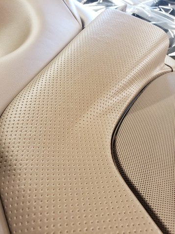

    I dont do much auto upholstery but lately I have been getting some work on the side. I have a quick question when doing perforated vinyl headliner with bows. What do you guys for you to not see through the holes. Specially on the pillars if you need to glue it down dont want glue coming though the holes..

    I use perforated vinyl when I recondition door panels and it gets glued. I haven't run into it coming through the holes. You should be fine.

    We apply adhesive from a paint gun, set at a narrow fan pattern. low pressure. We pre glue the headliner on the table prior to installation and apply glue to the perimeter of the car during installation.
