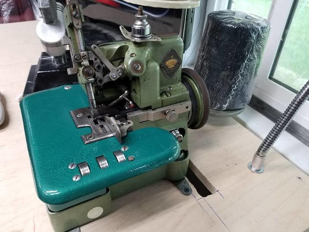

    Got myself a karpet king serger super cheap. I bought a bunch of smalls from NC carpet that needed replacement.

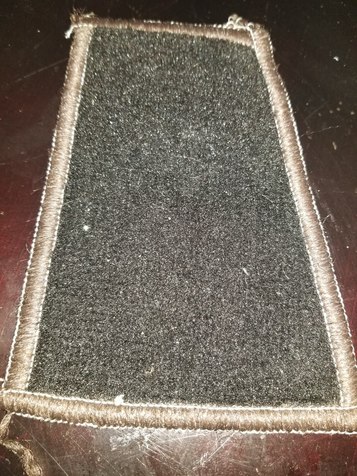

    I took it to my mechanic to get it tuned went to pick it up today and it sewing pretty good he is using aviation type yarn it comes in big spool.ktpm74cvznwnnewc.jpg

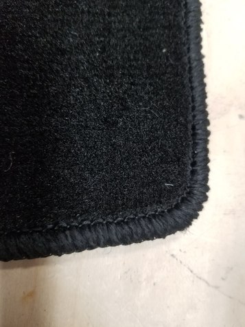

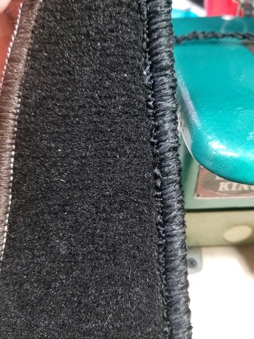

    Now I got it home tied my threads to his thread to thread the machine. (I have not messed with his tension settings at all) now this is how is sewing at homevb5a3fw99bt5vjnq.jpeg
    As you can see the black yarn looks pretty crappy compared to my mechanics brown yarn stitching
    I bought my yarn from NC carpet. What could have cause the machine to be out of wack during a 15min car ride.

    The machine is most likely not out of wack. I do a lot of carpets and have found every time a roll of yarn is changed tensions need adjustment. Also after doing a lot of practice it becomes obvious what needs adjusted. In my opinion sergers do not work like sewing machines,adjustment and practice is needed. Chances are the large spool of yarn he used was a rounder yarn NC yarn is slightly flatter which call for adjustment I currently use both types of yarn depends on who has best color match. I have also found different spoils of yarn feed differently which also can cause issues as well as what type of yarn it is wool, nylon or polyester

    I should off taken my nc yarn to set up the tension for my yarn instead of his. But his does look round and a little more stiffer compared to the flat nc yarn...

    That would have worked to get this job done but as I stated I have found tensions to change with rolls of yarn. I typically have love hate relationship with my sergers. Currently have both the small NC which is the same as yours and 2 81200 larger sergers ( I use one for back up) once set up they all run great

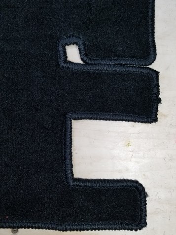

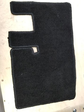

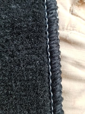

    Looks like the stitch lenght was to small for the NC yarn I bought. So they lengthen the stitch it looks alot better.9gqlos1olyihwfvl.jpg
  • Joe Chiaramonte
    That does look better. May still need to play with the tension. I place reference marks on my tension knobs and right down how much I turn them in or out so I can turn back to where it looks good if I change it too much. Keeping good sharp needles in machine is important as well. I have found the thicker the yarn the larger the stitch length needs to be. I have used both the polyester and cotton. I really do not use that serger much any more as it doesn't do inside corners or circles that easy.

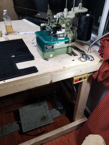

    First time using a carpet serger Karpet king got it for $150 bucks plus parts that need replaced.

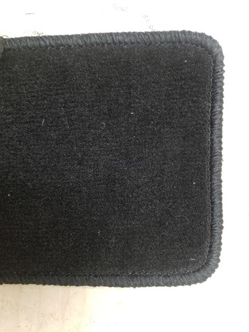

    Practicing on corners.
