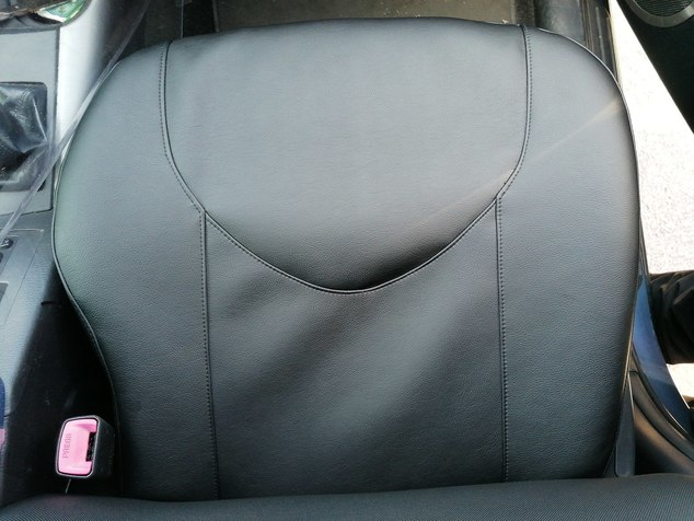

    Now I'm trying to make my first seat cover, but there are some problems, i see waves in some pieces.. could some of you please tell me how to resolve this?

    Not sure the seat construction, but it looks like it’s just too loose of patterning. Almost look like if you pulled down on the piece in the picture it would tighten up.

    Thanks for your answer.
    When I pull it, the waves looks little, but still there.

    no listings? Cover is too big, many reasons for that example. Motor trimming is a life time skill, you don’t get good after 1year or 5 years or even 10 or more. I am 53 and I am producing my best work daily, I started as an apprentice, just saying..

    Thanks for your advise, I see it's a very difficult work... With patience maybe I'll learn a little bit...
    I'll try to remake the cover .
