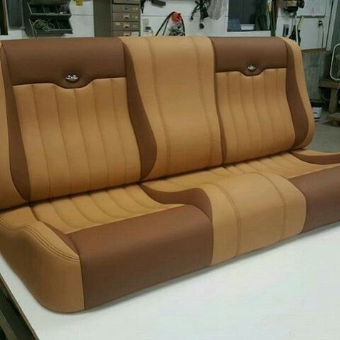

That top seat the 2 tone brown seat looks like a Snowden seat. I tried to contact them on how they keep it down but got no reply. Which is weird cause I may be wrong, but I feel they sell the seat frame and foam along with finished seats. Think they’d help out a potential customer.
