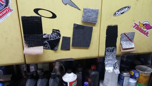

    Just a heads up... watch out which butyl brand material (dynomat) you use directly on the floor pan. I have 4 different samples of various brands stuck to a steel cabinet in my shop. All are fine except the Eastwood brand. It melted and fell on the floor. That could create a huge mess in a nice car.

    Here is a pic of Eastwood butyl vibration damper that i mentioned earlier. Out of multiple brands only the Eastwood brand melted.

    The problem with the Eastwood was not the adherence to the cabinet but the butyl itself melting. It stuck to my cabinet just fine, then melted and slid down 4-5" till it just fell on the floor, leaving a gooey mess behind. can you imagine that dripping through the drain holes in the door of a $$ car? It may have been a one off problem, but I'm not willing to trust a customers car to a product I have witnessed failing.
