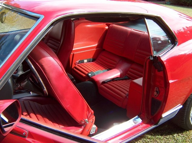

    I am not sure of any repro seat covers available. I did a '69 Mach 1 from scratch about twelve years ago. Original materials were obtained from a local source and do not know of anyone that has real comfort weave on the shelf.
    SMS does not have the correct material. Al Knoch does not have the real material. Reproduction comfort weave vinyl is embossed to look like the original, but it is not breathable and is a close substitute at best. I will try to find some pictures of an original interior, but I can not promise results

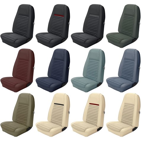

    Ok. I did a search and found that TMI makes a kit. I cannot endorse the product or the fit, I also found these images on the web.765f7mpjdvkblqkj.jpg
    The kits are available through CJ Pony.

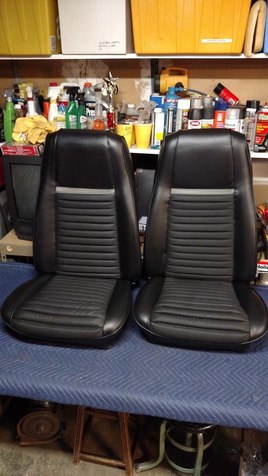

    I did a set of the TMI covers for a customer with a 1970 mach 1 a couple years back.
    They turned out real nice.
    The original covers actually were not a comfort weave, but a dielectric stamping and the reproduction covers were a spot on match.
    I will say I am not a fan of the TMI Repop buns though... Very very stiff.

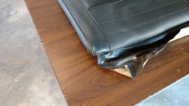

    here is a closeup showing the original insert material (from the backseat)
