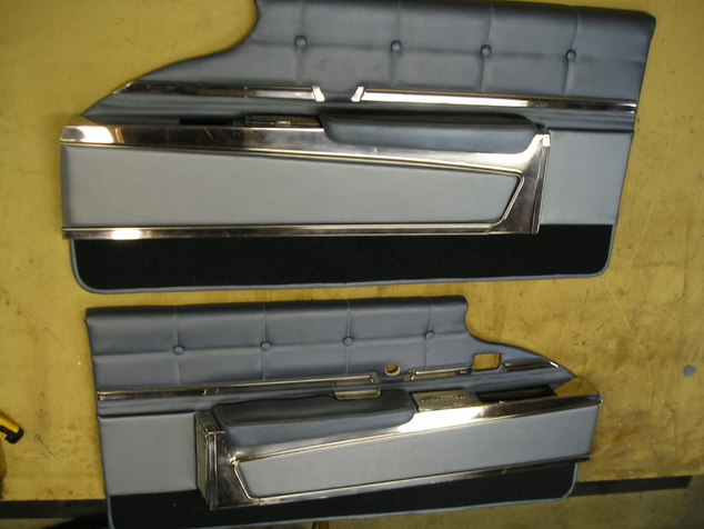

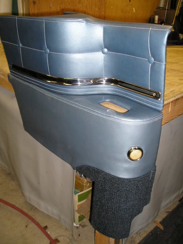

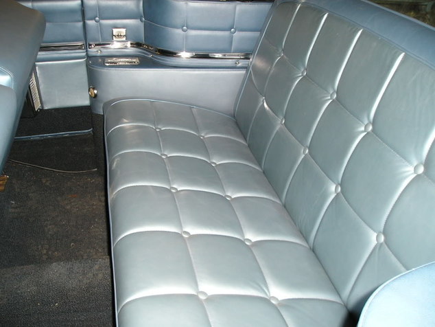

    A '60 Lincoln drop-top I did. The seats are leather & the door panels are vinyl. No problem acquiring the proper colors of leather, but finding matched vinyl was near impossible.
    So I bought vinyls in colors as close as I could find, then had dyes color-matched to the leather & sprayed the roll stock before any pieces were cut out.
