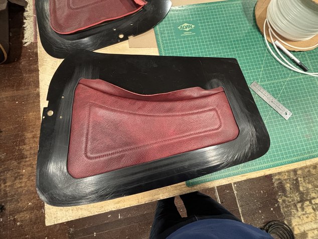

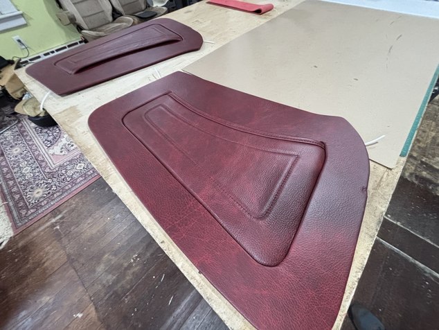

    Thanks guys! I ended up going with abs… I have a supplier about 40 minutes away and can pick up 4x8 sheets…. I wasn’t confident that the panel board would hold up long term. Especially with how the door pocket was made originally.
    I’ve got a few things to tidy up but they are a pretty accurate representation of the original.
