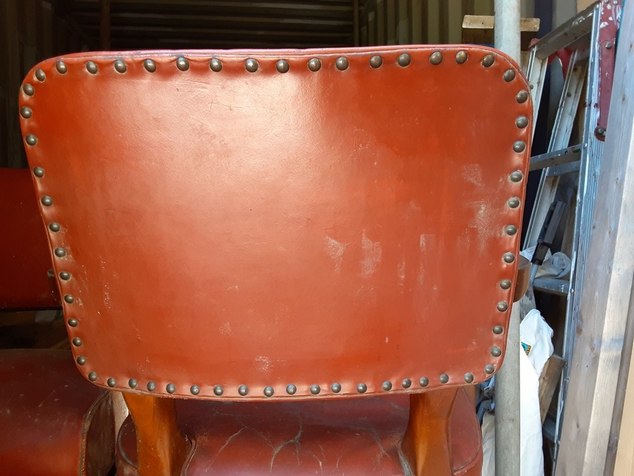

    Any thoughts on how to make a back without decorative tacks?
    Someone in the neighborhood asked me to look at some chairs. I've done a lot of restaurant and medical furniture, but not much home furniture. The only thing I can think of is wrapping a cardboard/plywood panel after sticking some flathead nails through first. I hate doing that with leather/vinyl because it's so easy to puncture while hammering them in.

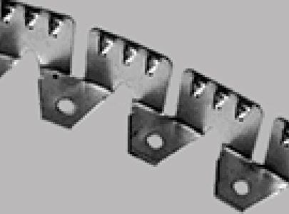

    @Jim Nishida-AdamsHello Jim,

    Hi Fred. That's the first thing I thought about, but I can't find it here. Wish I'd brought some with me . . .
    I would be happy to send some your way. Always willing to help out. It's great to hear from you, been too long. We all miss your comments.

    By the way, I finally located some flexible tack strip (ply-grip/curve ease). Thanks for the kind offer!
