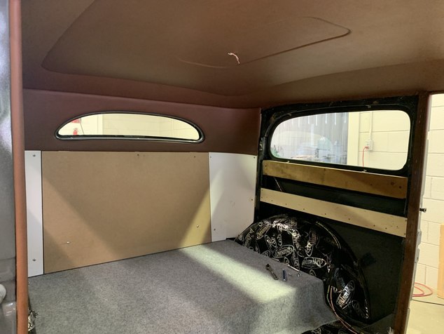

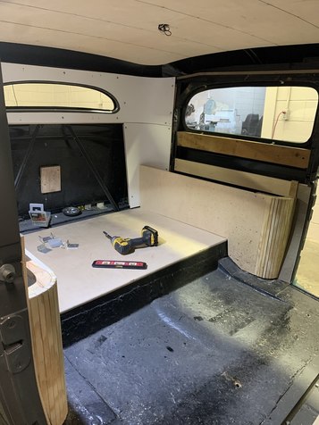

    Have you ever tried using foamed PVC sheets? You can get them in 2mm, 3mm, 5mm.. my favorite brand is Palight. It bends nicely, machines easily and holds a staple. Comes in 4x8 sheets and cheaper than the panelboard. I get it at Grimco, but all the sign supply places have it
    https://www.grimco.com/Catalog/Products/PalightPremiumPVC
    Here's some in a 35 Chevy I'm doing right now
