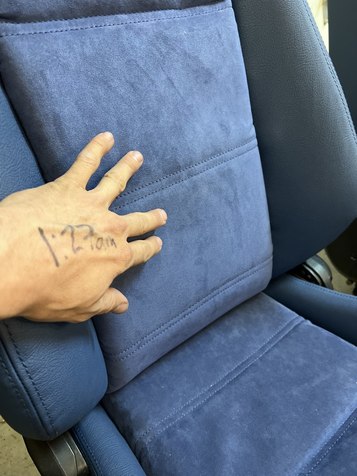

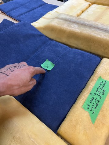

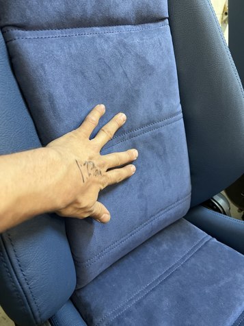

Hello people, we are doing an interior for BMW e30 and have some puffiness behind the sew foam on the seat where there are no pull bars. I don’t like the alcantara popping away slightly from the original foam and was wondering what people do to help with such an issue.
It’s not defective foam, I think it’s due to the fact that the sew foam is rigid and when it wraps around the edge it props the middle up. I was considering next time sewing/gluing a plastic piping behind the top stitch and pulling it back through the foam like a pull bar but less prominent
