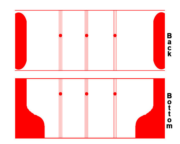

    The original cover was a wool broadcloth. The lower cushion cover was sewn with a waterfall edge. The seat back had sewn boxing along the outside ends. The seams were finished with a small french seam without any welt cord.
  • Naseem Muaddi
    and probably no pleats, right?
    There are no pleats in the seat cover. The original cover did have 3 sets of 3 vertical lines sewn into the cover. A #40 button was used to help tension the seat cover.
    In my illustration the pieces are shown with the detail of the bolsters, seams and decorative stitching with the button placement. The photo is from the internet.
