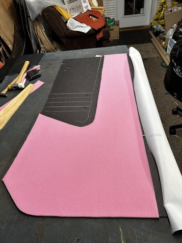

Wondering what everyone’s techniques are for wrapping door panels to get a nice flush finish on the sides when there are multiple layers of leather.
I make custom panels out of PVC and when I put the insert panels in I am getting some bulk where the insert wraps around the side and back of the main panel. There are 3 layers of leather in those spots so I’m wondering what I can do differently to make everything flush. Any help is much appreciated.

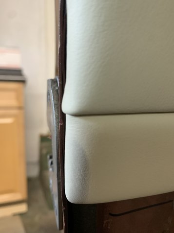

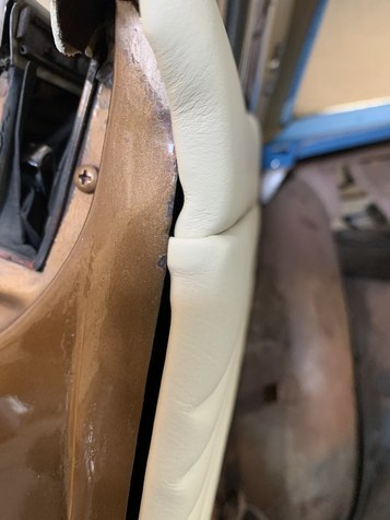

Simple as notching the edge of your panel to match the thickness and # layers that you are wrapping around the panel, then under cut the material you are wrapping around the back.

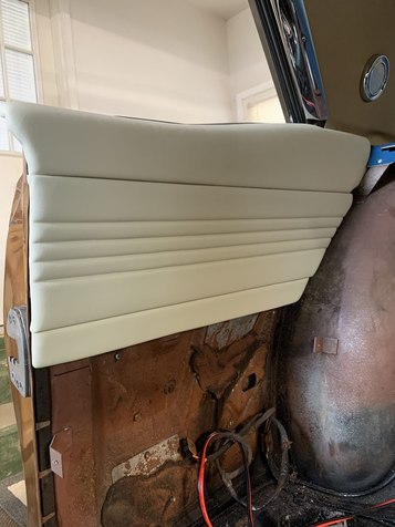

This panel was made for a 1963 Buick LeSabre convertible. New original vinyl was applied over waterproof panel board. All the seams were sewn to make it look like the original die-electric stamping.
