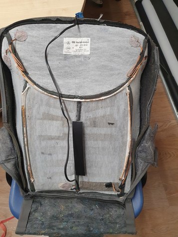

    I have a 2002 Mercedes SL63 in for some work and I have removed the seat covers to find electrical connectors, pads and wires within the cover. The car has pressure pads (occupancy seat belt warning) heated and cooling seats etc, but not sure how to re trim it with the connectors. Does anyone have an suggestions please?

    The heater pads double up as the filler, your need to unpick it all and sew it back in.

    All sorted now as I unpicked it, and glued it to the foams before dropping the new cover back over it.
