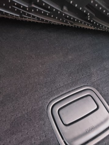

What type of carpeting is this? It is thin, usually found glued on plastic panels in the rear trunk area of newer suv vehicles and the spare tire lids. It is not the same as the actual carpet and it is pretty thin. Dlt and keyston i cant seem to find anything like it. These photos are from a 2018 jeep grand cherokee rear truck area.
Search needle punch carpet at Miami Corp also can be found as Superflex which I believe is a backing less carpet used for speaker boxes and other things like those trunk deck boards
