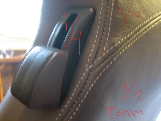

    How do you guys get a nice flat seam when doing a french seam at corners when using 1/2 scrimm foam at fronts and 1/4 at sides of seats. Something like this picture I found online. 7qqyg9wyfnu1w3zz.jpg
  • Adam Gabriel
    I doubt they used any foam on the backsides of that material.
    I've seen 1/4" then they run the skiver over the material and it will remove the foam in their seam allowance.

    do you think they attached the scrimm foam on the seat foam?

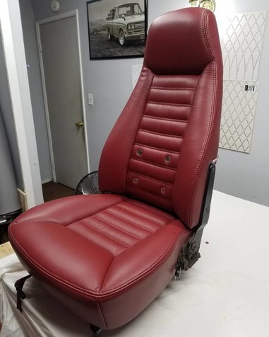

    I recently did these did 1/2 scrimm foam at tops and 1/4 sides and cut off the foam from the seam allowence but I still fill they are bulky.
