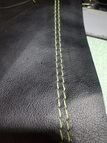

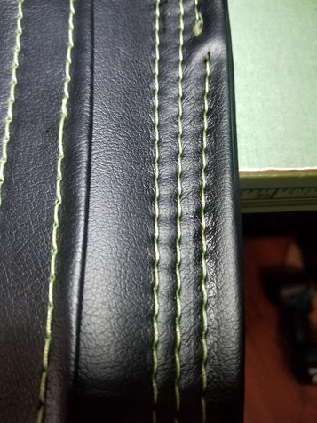

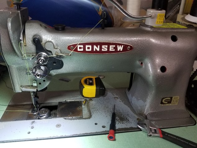

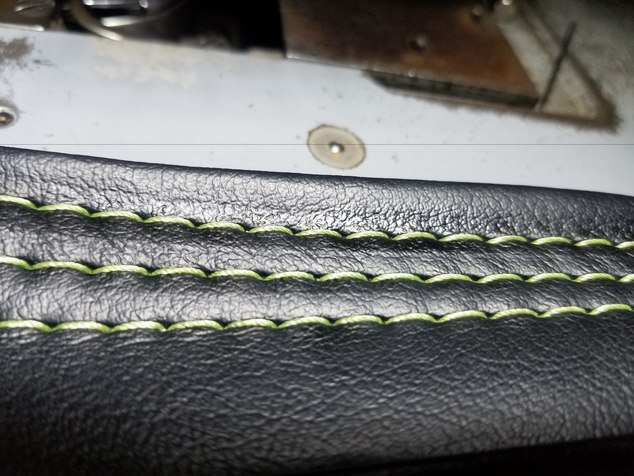

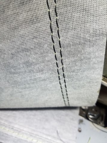

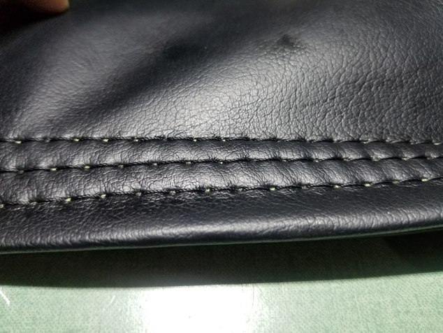

What do you guys think.
Jose Tarin
Using a consew 225 using green tex207 at top and black tex138 at bottom
gr
Jose Tarin
Nick Lupien
How do you feel about it?
In my experience, it looks about right for a thin material with a large top thread and a thin bobbin thread.
Nick Lupien
Jose Tarin
Nick Lupien
I feel ok about it, Its 4 layers of vinyl. Leather and foam should be fine.
