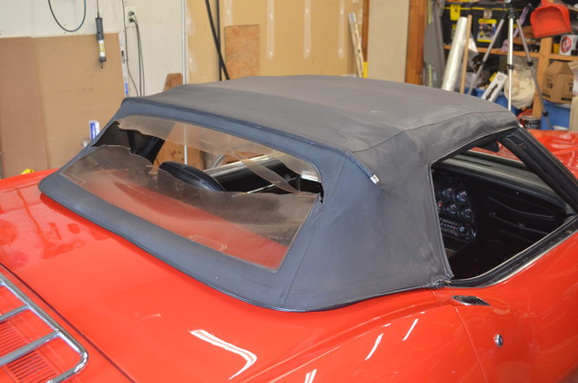

    Hear is an image of a corvette top that was serviced by an automatic car wash. Show her this so she can see what her top will look like in two years.n62y9lp8r2r8divn.jpg
