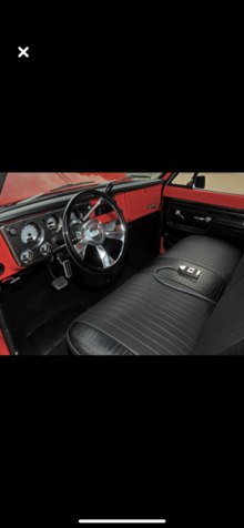

    I’m not exactly a beginner but, I have never worked with exotic leather before. I have been trimming about 4 years and was taught by two uncles; the two of them have 70+ years experience but didn’t seem to know much about gator. I am doing a seat for myself in a pickup I am building. It is a Chevy bench seat. First, where is the best place to buy a hide? Also, do I need heavier thread or will 69 work? Any other advice or tips would be much appreciated. I will try and post a pic of something I found online I like. Anyone know who did it?pn5rg4eoptw09agl.png
