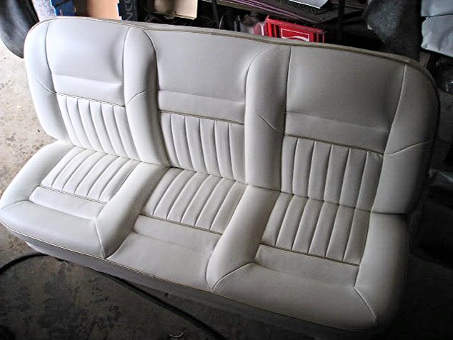

    I put a toggle switch on an electric clock to track time on individual projects... learning as I go. This seat: repaired frames; carved foam; patterned and completed took 33 hours. The front seat took 40. I show customers the patterns and photos of the process. People just don't realize the time involved in this work.
    I agree with @Gareth Judd. Everyone will work at a different rate of speed.

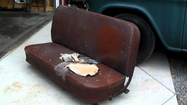

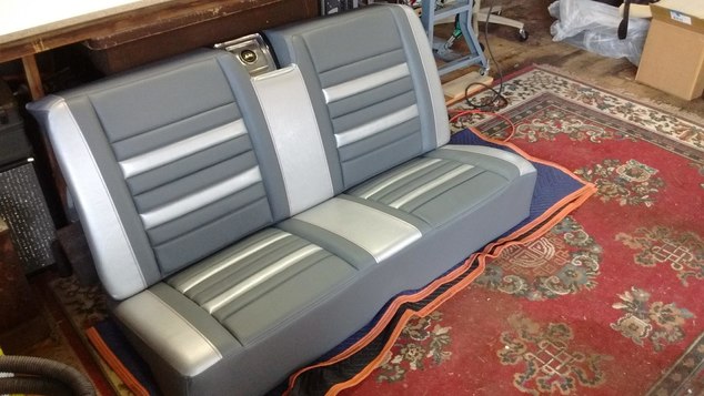

    From start to finish, this took 38 hours.
    When I do custom stuff, I never repeat myself. Every one of these projects is a one-off.
    If the customer has no ideas, no real plan, no basic renderings, & only gives me general parameters, ("Can you make it look like buckets with a center area for my small dog?") then I'm making it up as I go along. When the customer dropped off the interior, the only plan for the seat that had been agreed upon by the time he left the shop, was the colors.
    Now if he had asked how long it was going to take, even after doing this stuff for (cough-cough!) 40 years, my honest answer would of been..."I don't know." I've used the techniques I did on this seat before & I will again, but I'll never repeat the design.
