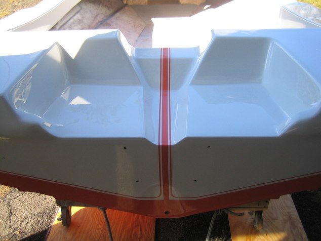

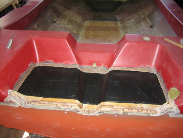

Cody, I think you are talking about reshaping the wheel ? I restored my own boat several years ago and got comfortable using West Systems Epoxy products. It's a bit of investment but it has a good shelf life and it will adhere to many substrates. With some practice you can make very light and strong parts. I reshaped the transom on my boat using styrofoam covered with a glued on trash bag. FYI, my experience with wrapping steering wheels in vinyl is to cut across the roll to the inside diameter.

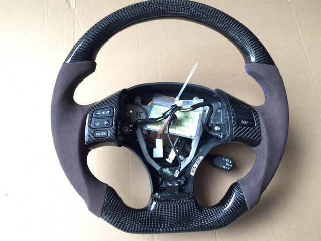

Yes looking to reshape. Didn’t know if adding foam was the way to do it or not. I’ve heard using a 2 part foam mix but needing a mold for the foam to swell and fill into. Looking at taking a factory steering wheel and making it more sporty like this in the pic. This is basically what my buddy is wanting to to. Take a factory s2000 steering wheel and at the details, and thumb area.
