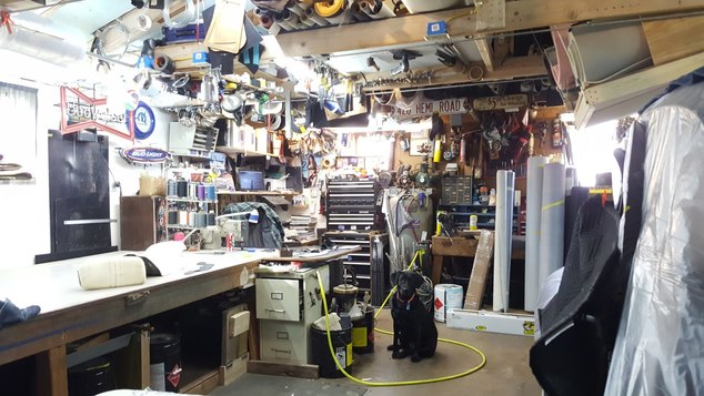

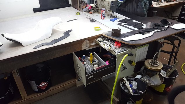

    -I spend probably 70% of my time at my main work table/cutting table directly in front of the 2 drawer filing cabinet. The tools and supplies I use the most are within arm's reach, mainly over head along with the materials used on the current project. I don’t like having to walk to the other side of the shop constantly to get the things I need.

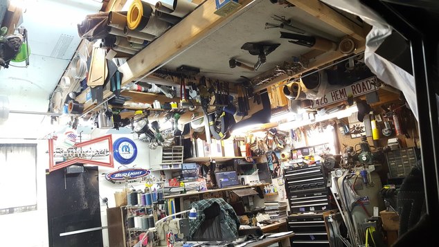

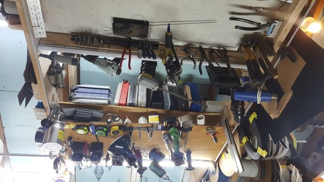

    -Directly overhead are many tools and supplies. Rulers, staplers, hog ringer, glue gun foam saw, drill bits, step drill bits, tape measurers, pins and curved needles, hole punches, drills grinders, squares, heat gun, micro torch, containers with screws & clips etc.
    -Another view overhead, of my main work area.
    -In the filing cabinet are more supplies. Staples, hog rings, button twine, rags, etc.

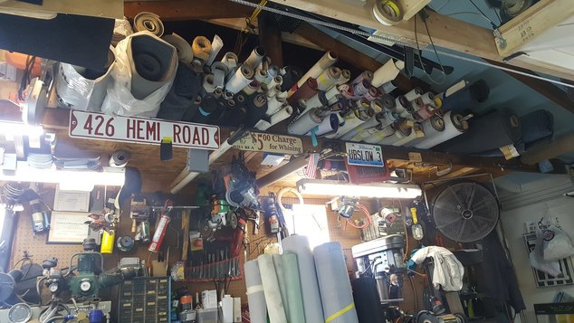

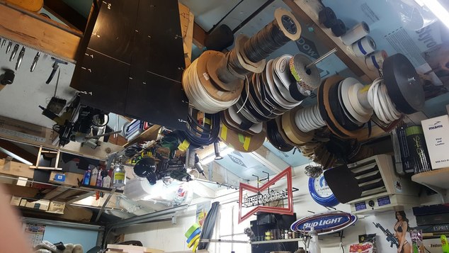

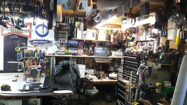

    -Above my sewing machine are as many roll goods as I could fit. And my often used patterns.
    -There is a 4 drawer filing cabinet next to my machine where I store thread, bobbins, product catalogues, scrap material, etc. Shelves on the wall hold computer, printer, samples, snacks, 2k watt amplifier to drive 8 speakers hidden in the rafters… I normally listen to talk radio but do like to rock out now and then. I also have a desk here which is usually just a catch all for anything and everything.

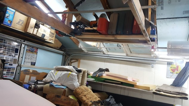

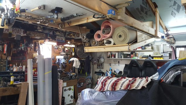

    -Drop down shelf to hold large rolls of foam, jute, rubber nib, carpet. This shelf is hinged on one end so it can be pushed back into the rafters to be out of the way.
    -more rafter storage

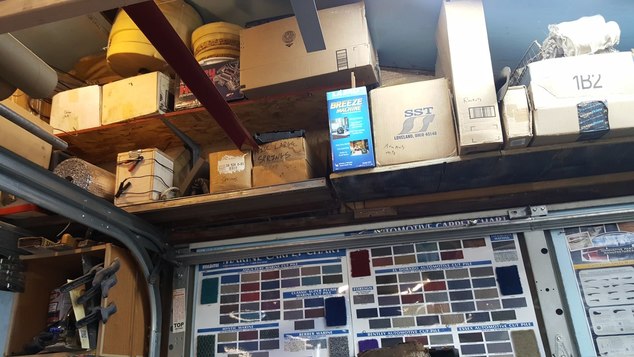

    -more rafter storage above garage doors.

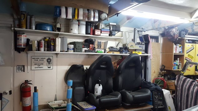

    -On the opposite side of my main work area I have shelves with various tools and supplies not used on a daily basis. The table that the seats are on, is hinged to the wall and flips up out of the way if I need the extra space. I also keep my welder, torch and other auto (non upholstery related) stuff along this wall.

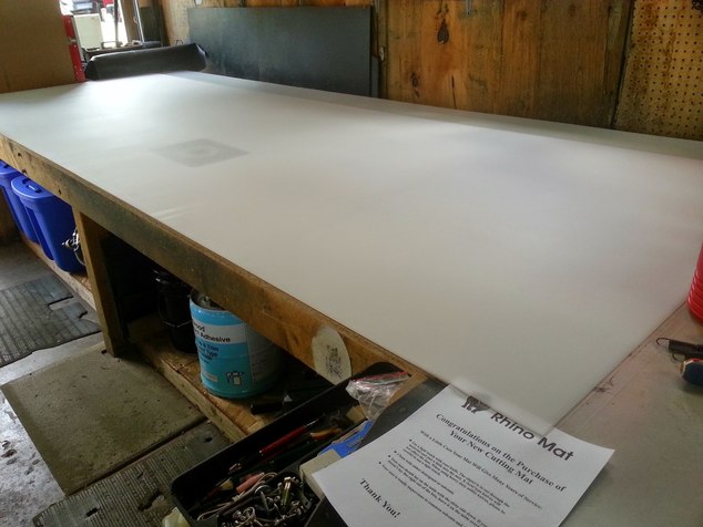

    -My table is topped with Rhino Mat cutting mat. This pic is from 2014 the mat was brand new, and now in 2018 it probably has about a year left before I need to replace it. I did flip it over, about a year ago. So it has held up about 2 years per side for me. I do a lot of cutting on this mat and highly recommend It.

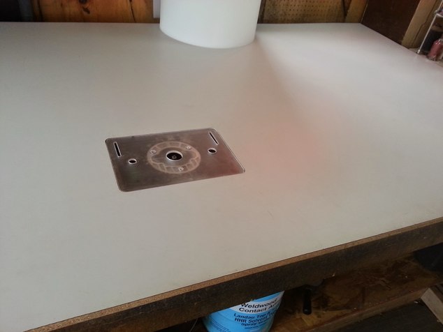

    -Under the Rhino Mat I have a router sunken into my table. Just roll up the mat and the router is accessible. I built my own acrylic plate, but there are many plates available for this purpose. Obviously there is a lot of storage space under the table as well for various things
