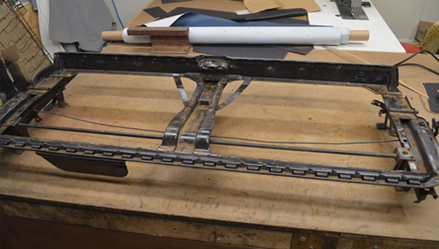

I have a new interior project on deck which I’m pretty excited about, it’s a 50 Ford 2D sedan that the guy wants to turn in to a police looking car Black & White the whole nine yards. he’s a retired local county cop, I haven’t seen the total car yet but he did drop the seats off and while taking them apart the frames are pretty rusty and broken and they will need lots of pieces replaced or if possible i would like to find a frame assembly. I have done some frame repair but not on this scale if I have to piece this thing together I found plenty of places that sell the coils and “zigzag springs” but I would rather go with a new spring frame for the front seats if at all possible, looking for suggestions on where to source this frame if it exists

These seat frames are not difficult to recondition. Once you have the seat stripped down, message me if you need any assistance. I can help with any issue you may encounter.
You may also want to check Snyders Antique Auto Parts. If they don't have the spring pattern they can custom build or use an available spring pattern and retro fit it to the base frame

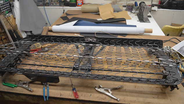

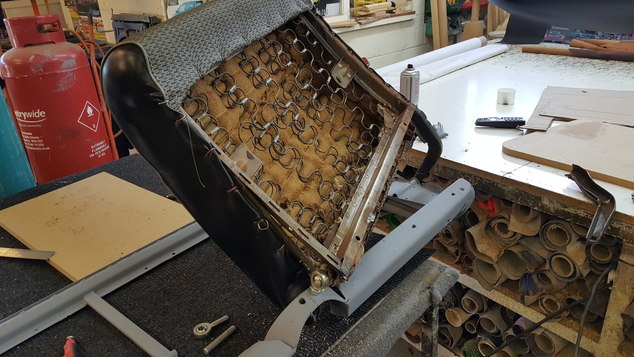

I do the most frame/spring jobs by myself. I bought some helpfull tools over the last years which make the job much easier. The only thig I dont do by myself is with the small coils with thin whire. Therefor I have a company I can order the common seatframes also with custom spezifications fitting on bodylenght and wheight.
Here are some tools I use.
Great osborne tool for vertical bending of ZigZag-Springs (need 2 of them):
for bending Springwire:
clamps for attaching wires or springs/making a bypass (there is a special pliers for it but you dont need it necessarily
There are also some other clamps but i dont know where you can get them. They are smaller and are fixing the springs at the metalband frame. But I only have my own stock on hand.

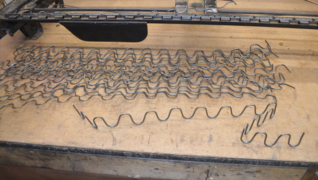

I just finished this lower cushion last night. The lower spring set the customer provided was for a 1946/47 GM front seat and it did not fit this 1950 Cadillac frame. I had to make all new springs from 9 gauge roll stock. Each spring was hand bent and set.
I almost hate to cover them with burlap because no one will be able to see them.

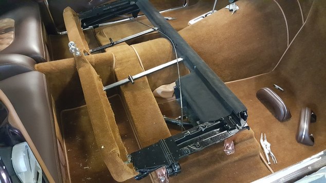

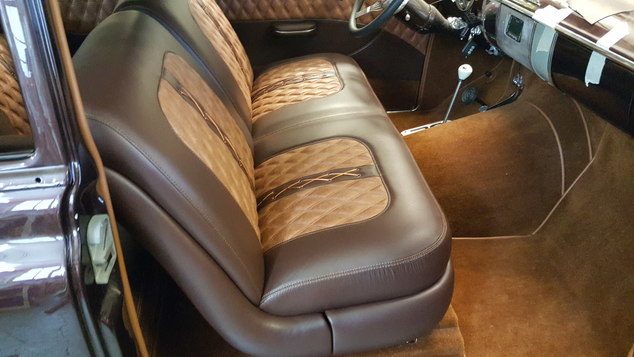

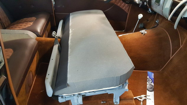

I did a 1950 chevy that had the body channeled over the chassis so much that the seat sat way to high so the only way I could do it was by making plywood base with elastic webbing over holes then soft foam so it still looked fat but the driver and passenger would sink down low when sat in .

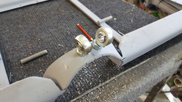

I even had to make a loop over the tunnel and fit rose joints to hinge back rest as the original hockey sticks had to be cut off
