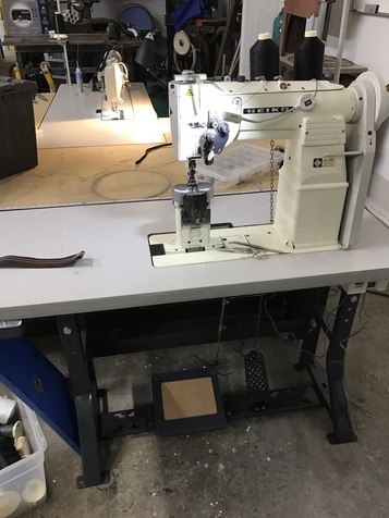

  • Steven M
    I have a Seiko split needle bar post bed machine. Well worth the expense.
