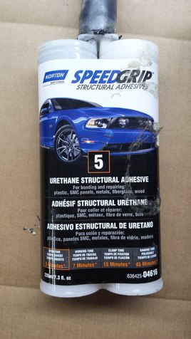

    Anyone looking for a great epoxy should try Norton Structural Adhesive Speed grip. Great stuff for replacing door panel inserts that need to be drilled out to be recovered. It beat buying JB Weld. For some plastics you will need to buy a can of adhesive promoter but it does make sticking to > pp < capable. It also comes in different work time.
    Ditto I use the same stuff myself. I normally just mix by hand for small projects. I do use the mixing tips for big projects. The tips are too expensive to use all the time. I also use various 3m and scotchweld adhesives. I generally go for the urethane adhesives. I'll put together a list of the ones I use if anyone is interested. It can be a bit overwhelming researching all the different options.

    Norton speedgrip

  • Warren McClung
    I use small cardboard pcs. And popsicle sticks and just sqirt a little out and stir. The tips waste to much.

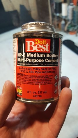

    For gluing ABS to ABS I have found the plumbing stuff from the hardware store works awesome. Just use acetone as a primer. I build 95% of my panels out of ABS and so far this glue has been the best I've found for ABS to ABS!
